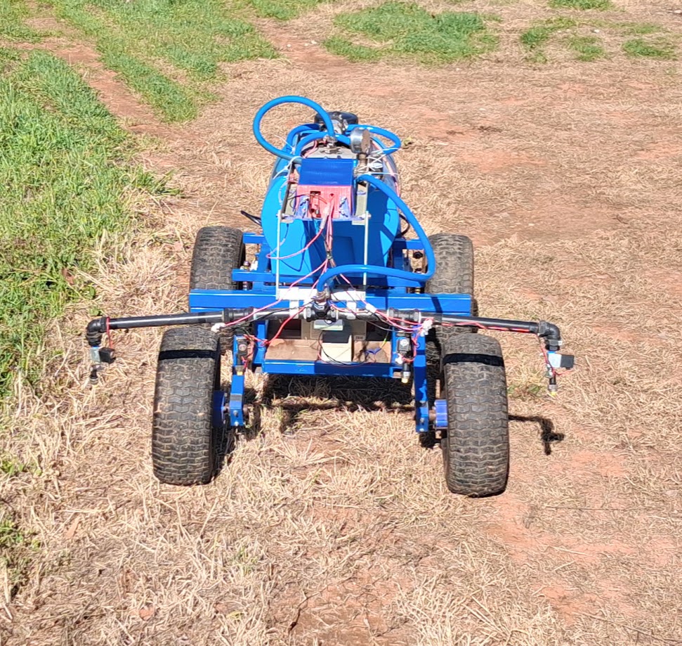

Thought I’d share this observation. I was doing some testing a couple of weeks ago with what I thought was water. Turned out the tiny amount of dregs in the bottom of the tank that I diluted with 20L of water had some glyphosate in it from some previous testing. Hence the dead grass a week later.
But interestingly I observed the nozzle boom width is 1 metre from outside nozzle to outside nozzle. But it sprayed out a strip that was about 1.4 metres wide. Handy.
I should have added that the nozzle height is approximately 400mm and I’m using yellow T-jets.
