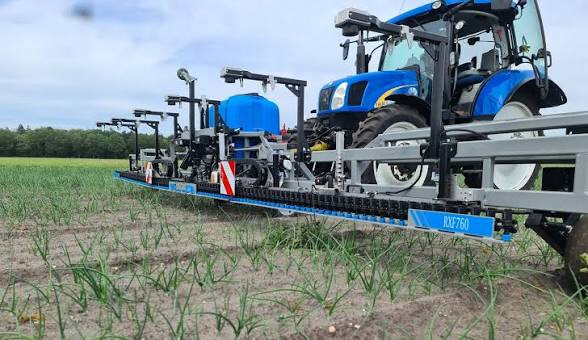

So if the cameras are in front of the tractor then you mitigate the dust issue, but do create accuracy issues around timing/turns etc and lining the weed up with the nozzle. The rumex precision sprayer makes a front three point linkage version for to solve this problem somewhat. If you integrate GPS with the OWL you can do speed compensation so it will turn on after a set distance.
In saying that I think the dust risk is manageable without moving everything to the front. Most spraying systems the OEMs provide only put the cameras in front for the nozzles that are directly behind the tractor/vehicle primarily because there is no room to see the crop.
