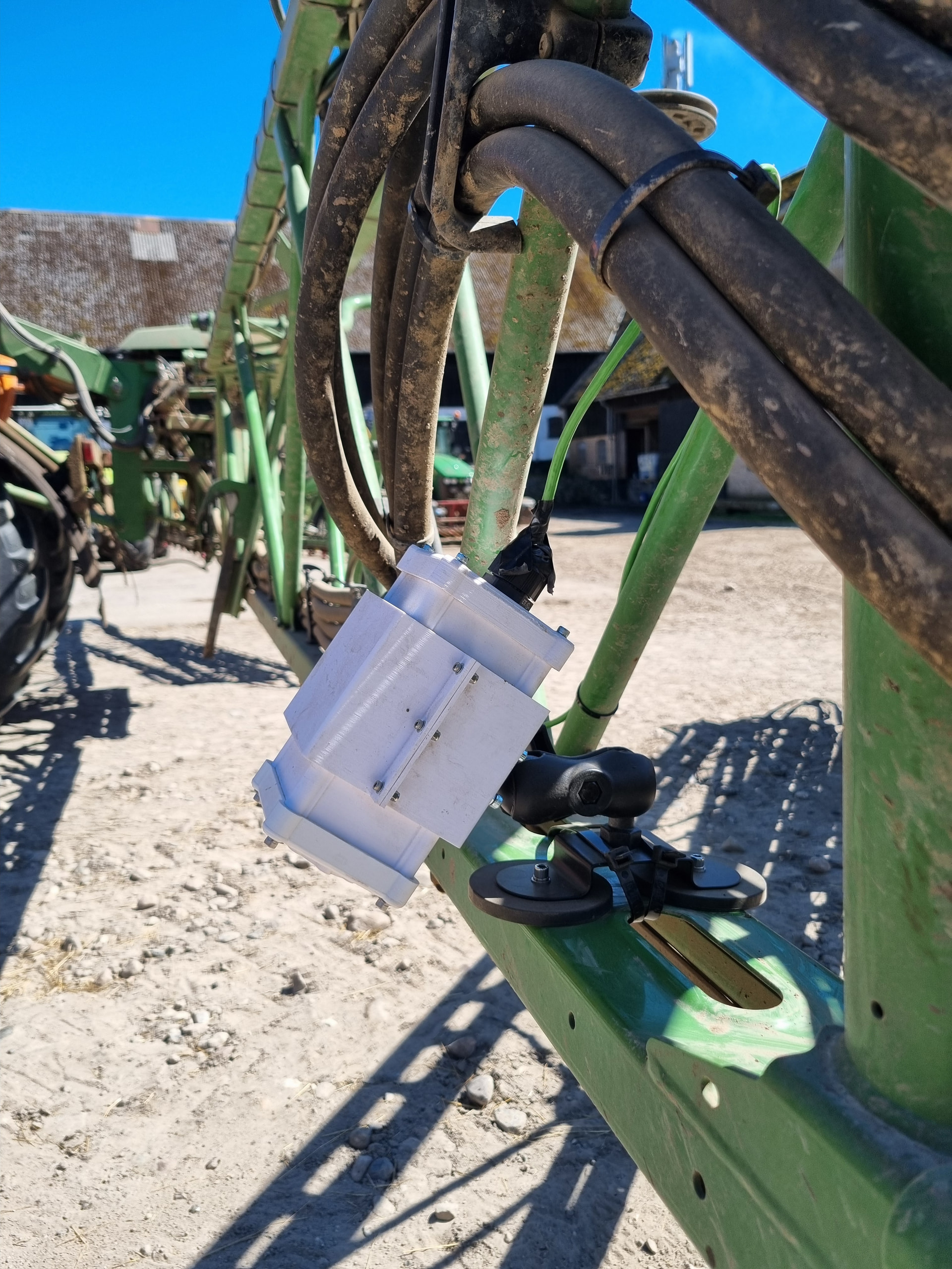

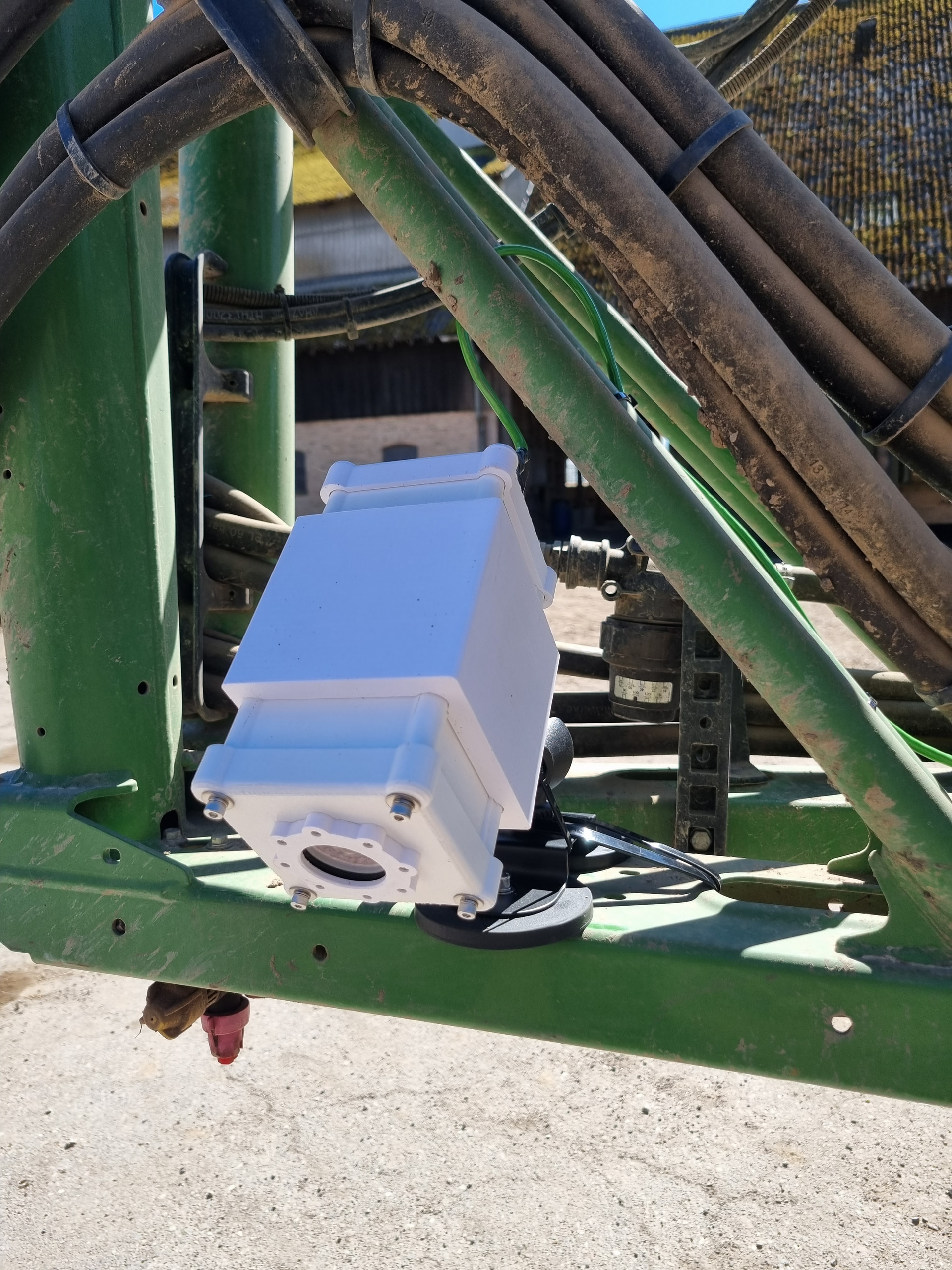

Just took a couple of 3D printed OWL2.0 off a 36m trailed Amazone sprayer today. They had been on there since April collecting image data. Sprayer was used for normal operations in Danish conditions.

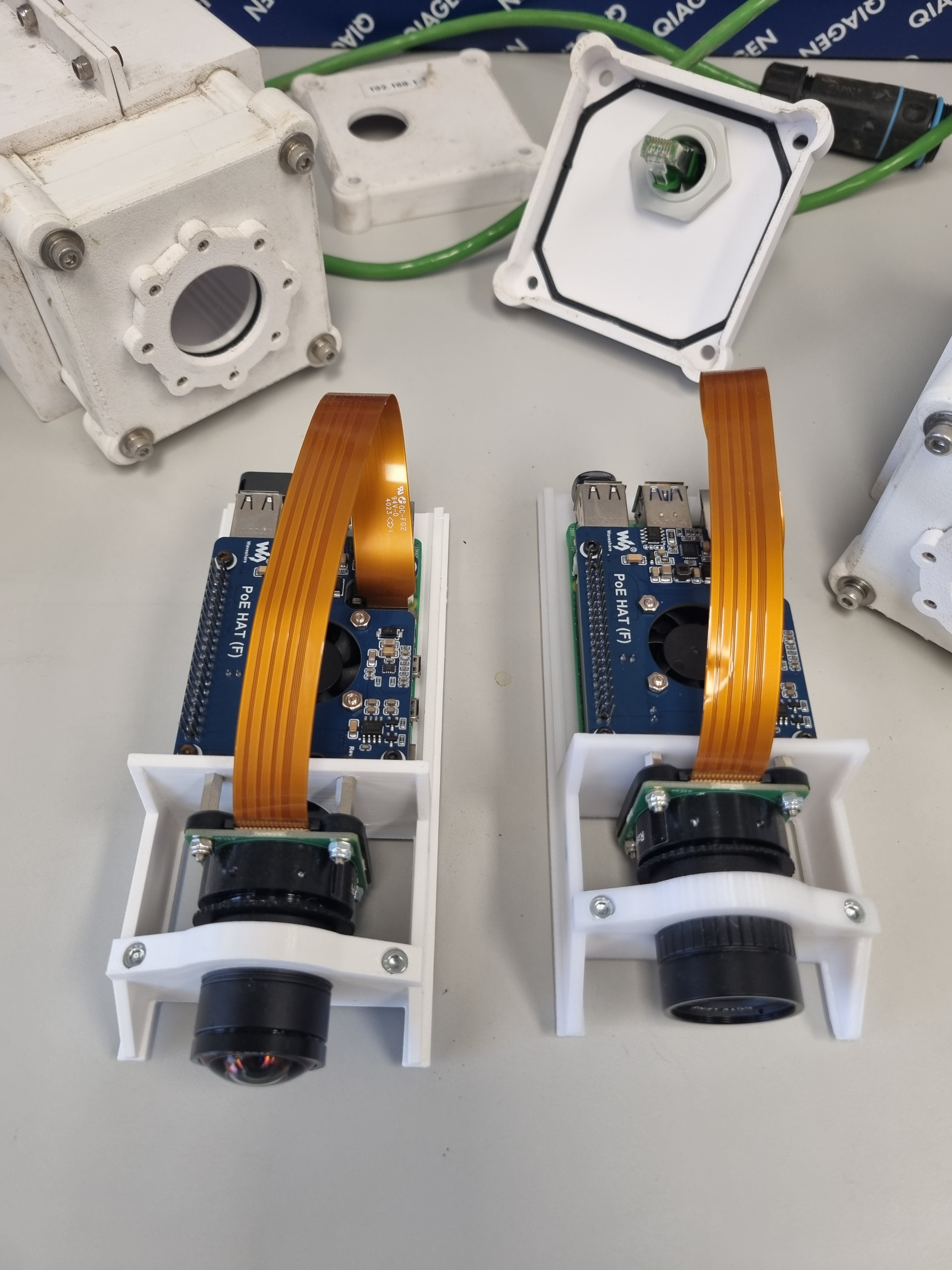

These OWLs were powered using a PoE Hat from Waveshare, Teltonika RUT951 PoE+ Router and then an ethernet cable running across the boom. It also used a 7 inch EDATEC display with PoE and then a 12 to 48V converter to get the PoE outputs to operate on the RUT951.

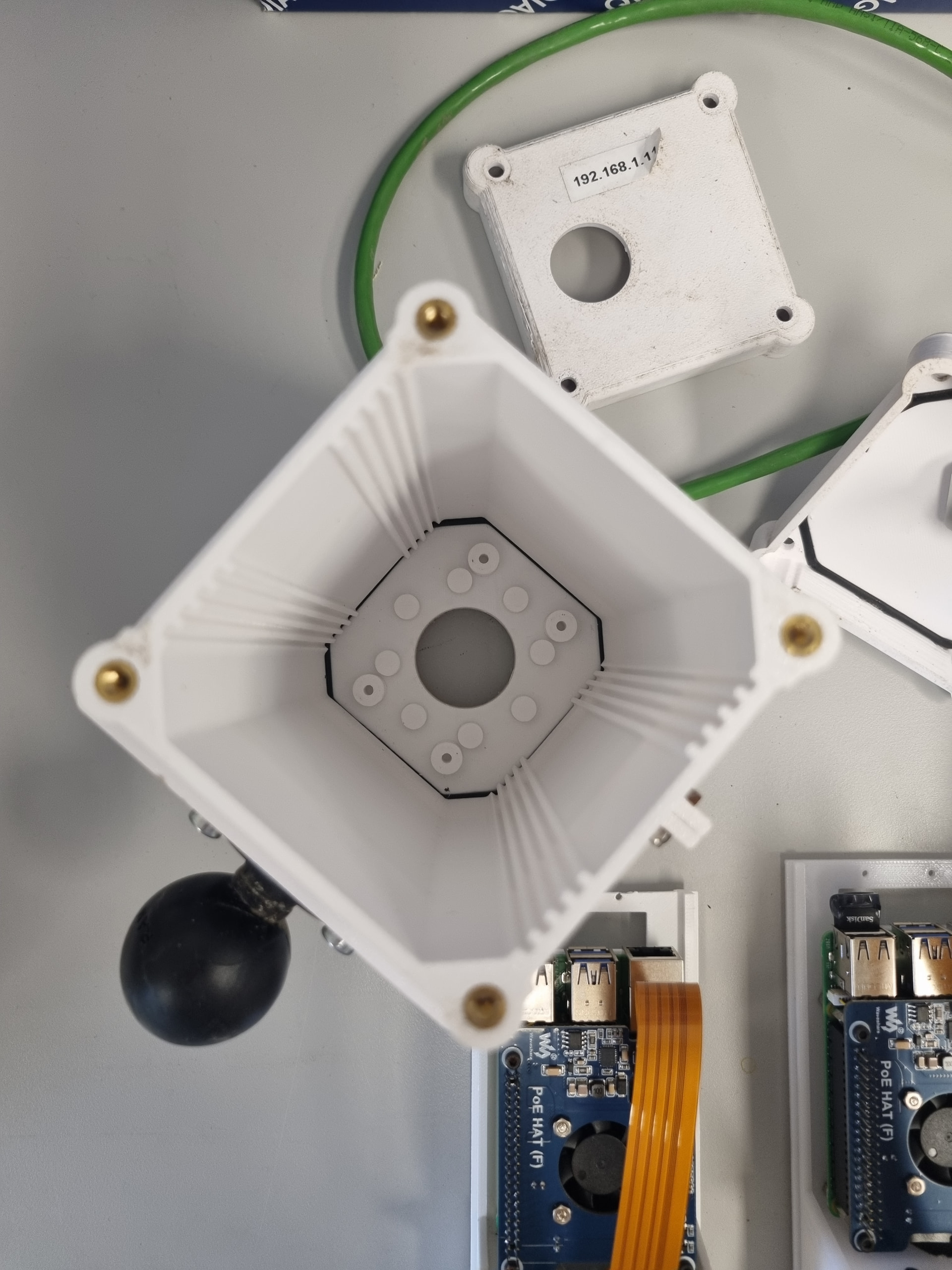

What I was quite happy with though was the enclosure being exceptionally clean on the inside. With the rubber seal, there was no dust or evidence of moisture inside and the UV/coated lens filter stayed really clean despite the rest being covered in mud.
Not quite Australian heat for the PETG, but either way, was quite happy with the robustness after 6 months on the sprayer.

The biggest issue we’ve had is the device getting quite hot even with the fan, because plastic insulates quite well. It still operates, but just hotter than I would like.

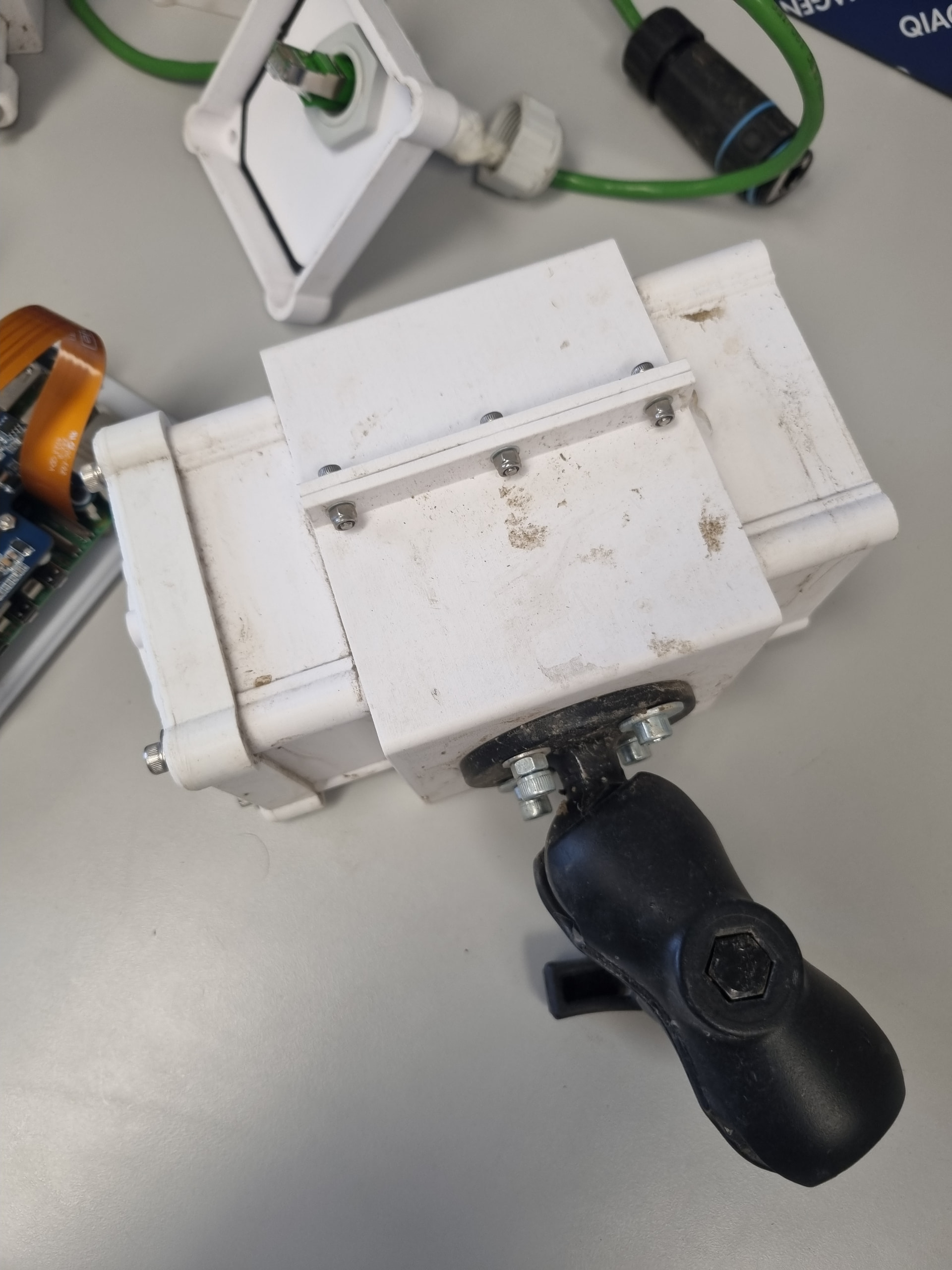

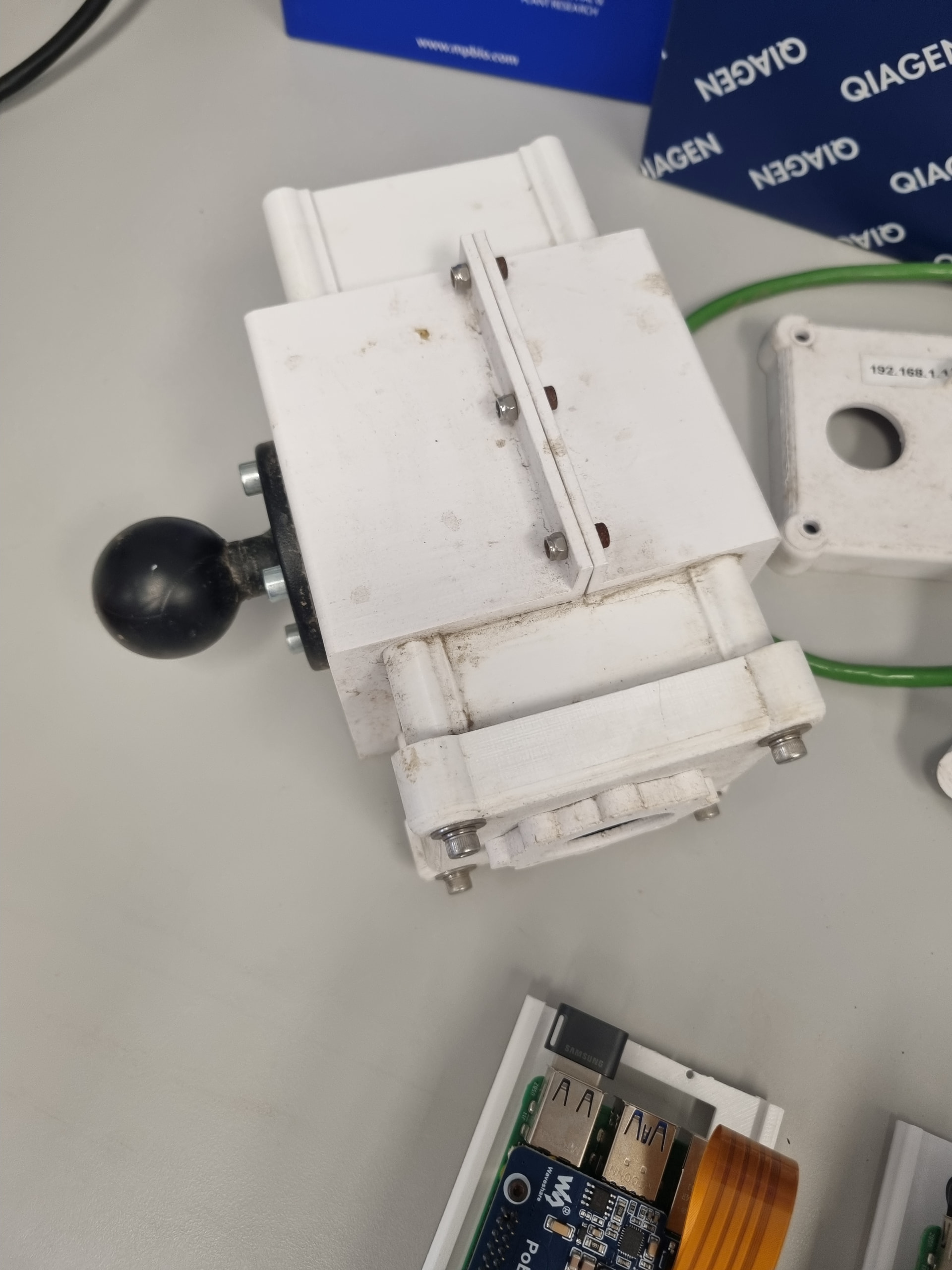

Ah yeh, I forgot to upload that mount, I’ve just uploaded it to the repo now.
It lets you use some M5 heatset inserts to add a RAM mount ball joint. It just slides over the OWL and then a few M3 screws to clamp it down.
