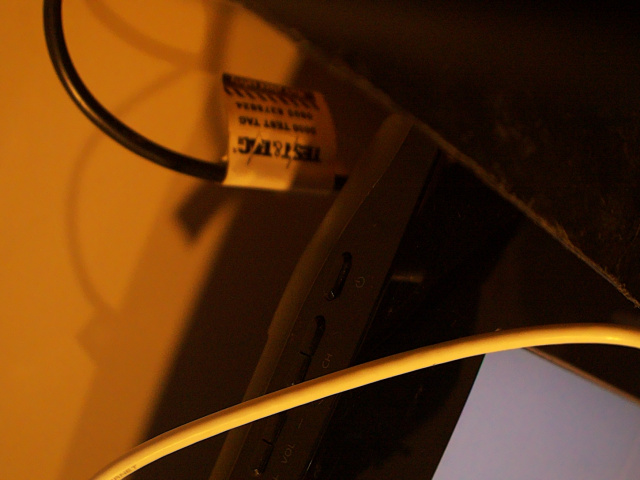

I am using the rpi global shutter camera sensor. The video stream has an orange tint to it compared to the viewing the camera feed through rpicam-hello video stream. Is this expected behaviour based on how OWL models handle the stream of it there something else going on.
We are wanting to use OWL initial for image capture for a phenotyping project where we want standard images using the record function but not sure how to go about getting this working.

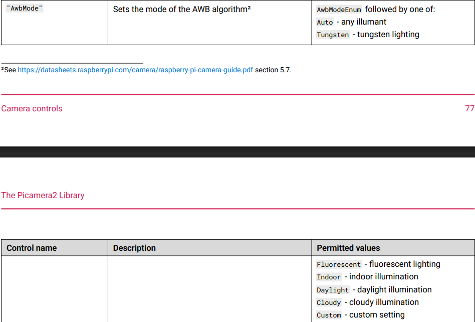

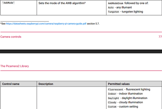

The rpicam-hello video-stream just uses the ‘auto’ mode. Auto white balance is pretty annoying when trying to use colour-based thresholds, so we fix it to at least one type. Turning it off would perhaps be better, particularly if you are using it for phenotyping and can control the lighting entirely. If you go to page 77/78 of the picamera2 documentation you can see the table of accepted values.
