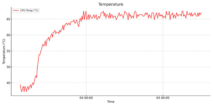

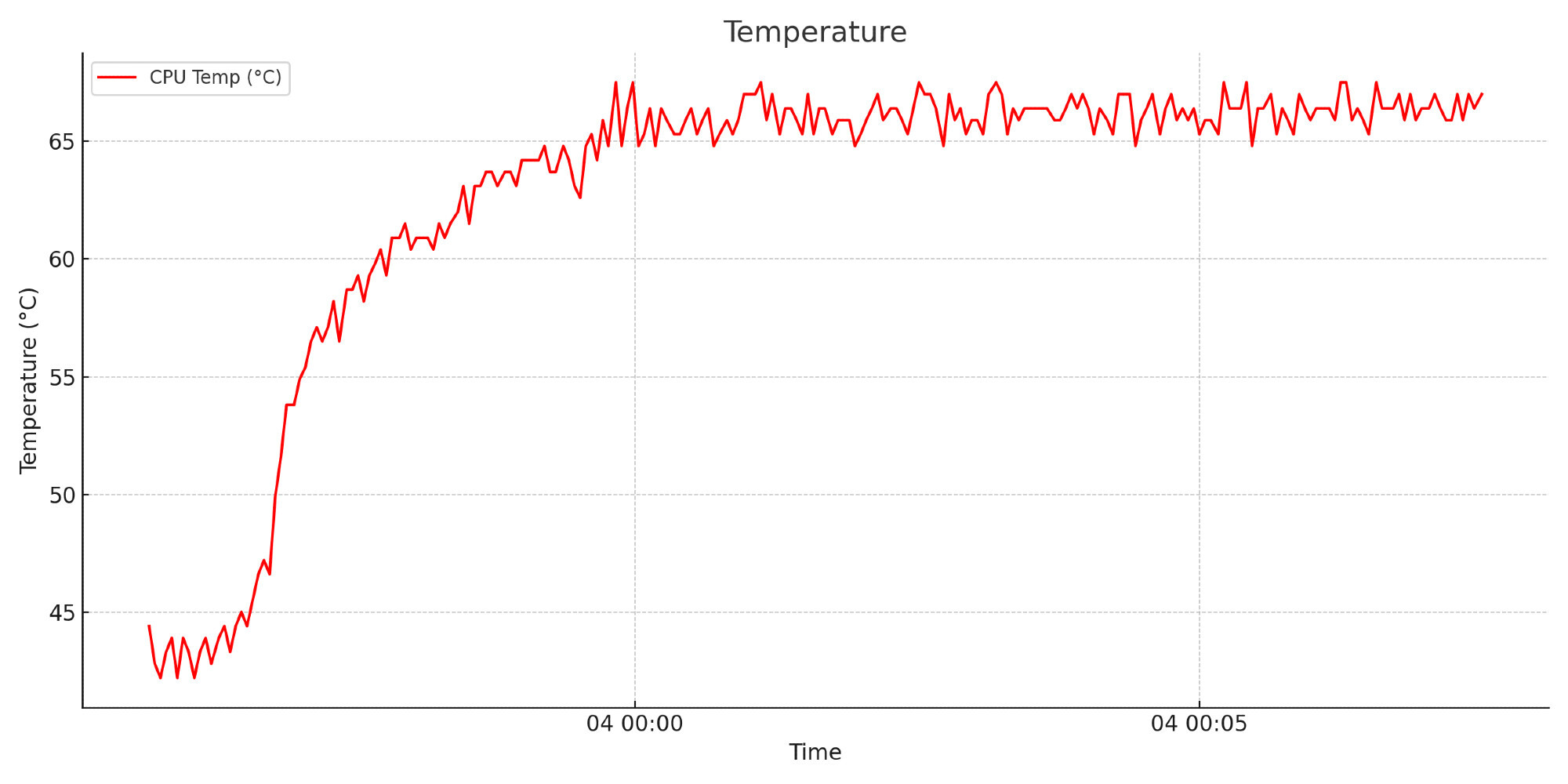

I did some testing with this and it running a YOLO model on CPU with/without fan and overclocked.
This is with the fan running full, stabilised about 67C - otherwise it overheated at 85C and shutdown.
