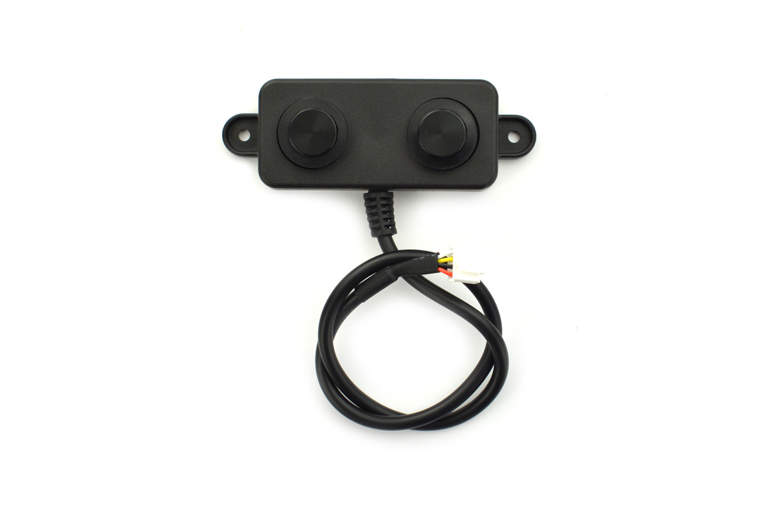

I reckon based on the height difference, an ultrasonic or height-based approach might be better. It should be quite compatible with the OWL - you’d just need to create some code that mimics the existing GreenOnBrown approach but set your relay number to just two.

I found a couple of sensors that look quite useful you could mount on each head. The alternative that is more consistent with the OWL system is using the OWL but then training on the stumps/regrowth for model-based detection. To do that you’d need to collect images, annotate and train a model, then run a camera on each side. You could run a classification algorithm and just do presence/absence of a stump which is much faster for training/inference.
