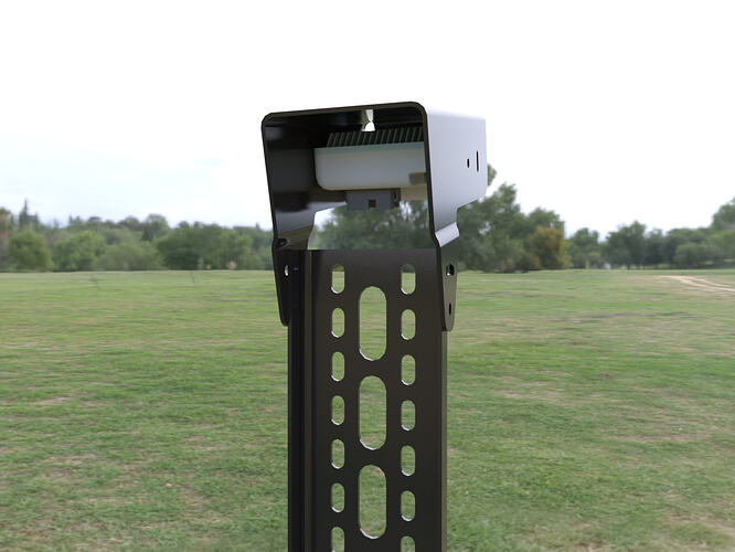

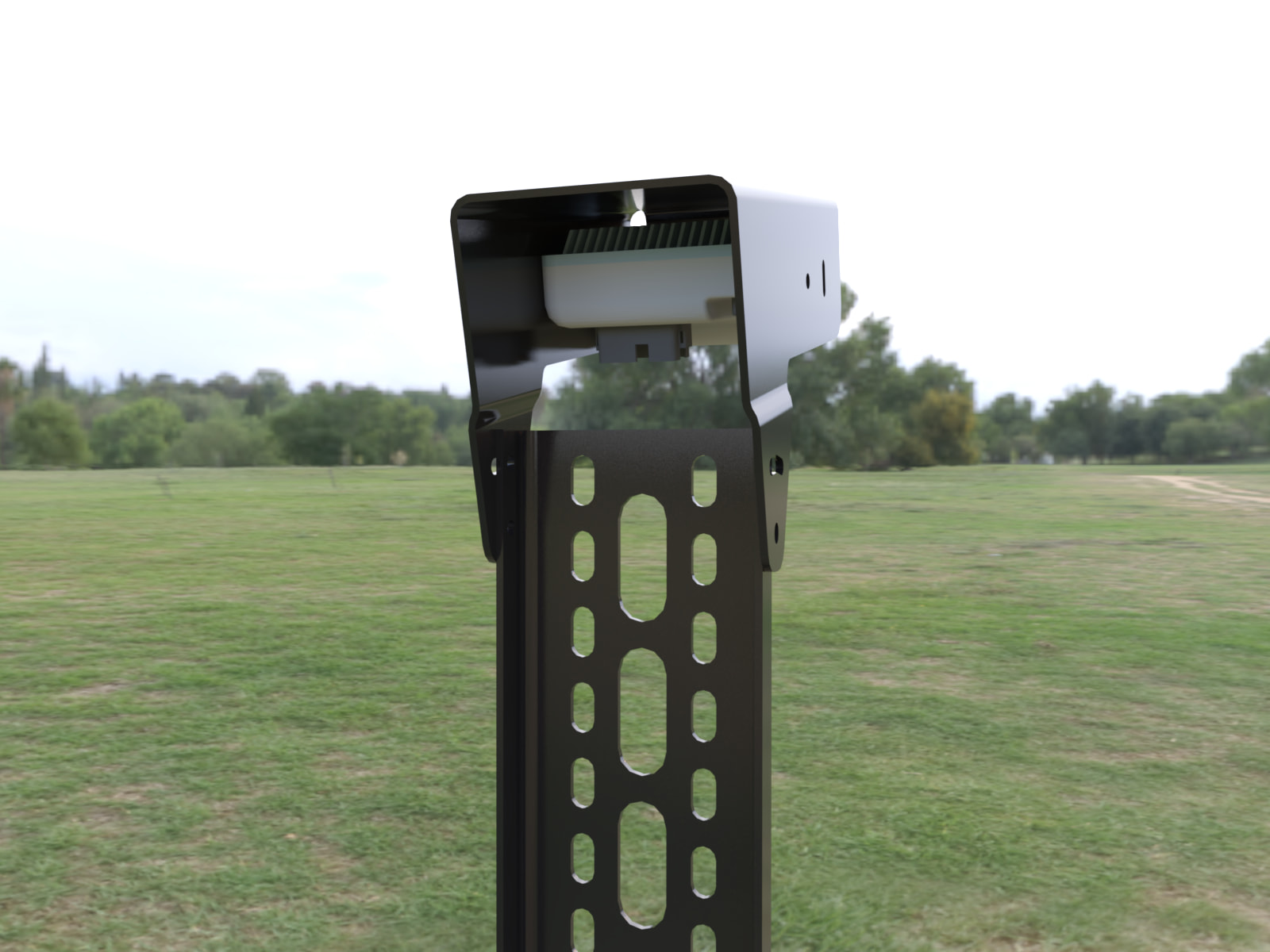

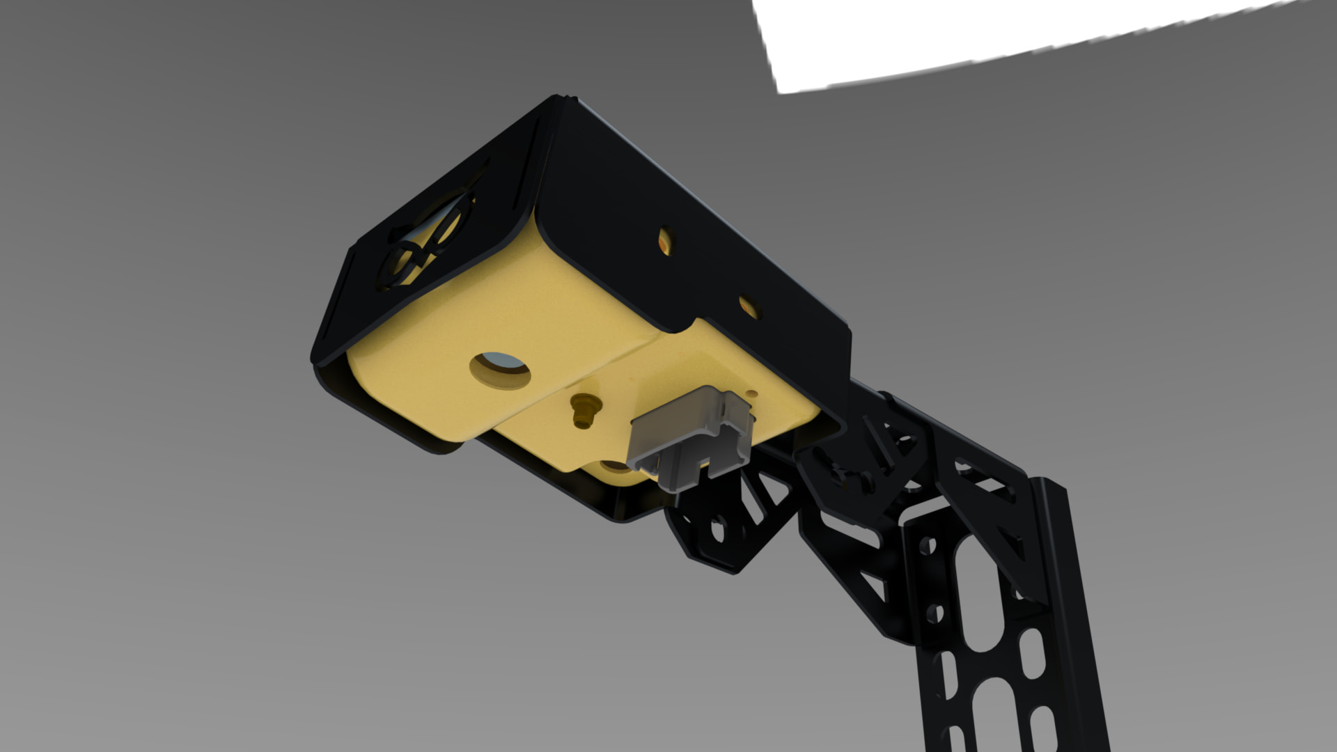

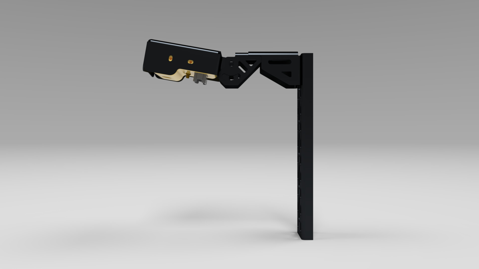

We have also been working on the mounting arrangement (with stainless steel) and enclosure design (milled aluminium). Some images below:
Very much open to suggestions on what the best configurations would be here. The aim for the shield is:
  1. Protection from hits/rain etc
  2. Reducing radiant heat transfer to the OWL from the sun
  3. Easier mounting with two M6 holes on each side
  4. Some small angle adjustments
The vertical piece can be mounted to the front/back of booms using M10 ubolts.
Prototypes should be arriving soon. Also a lot of work actually starting a company and making sure everything is lined up and ready.
Ideally we’re looking to open for pre-orders for the first batch of 100 in July.
Cheers,
Guy

Great work! Nice to see that the mounting acts as a sun ray shield!
The biggest upgrade from V2 to V3 is hardware, so you should get lots of improvements with the V1 to V2 move!
Possibly influenced by some of our discussions around heat management I think! We also looked at the calculations and with any incident sun, it becomes pretty impossible to cool the device without any active cooling.

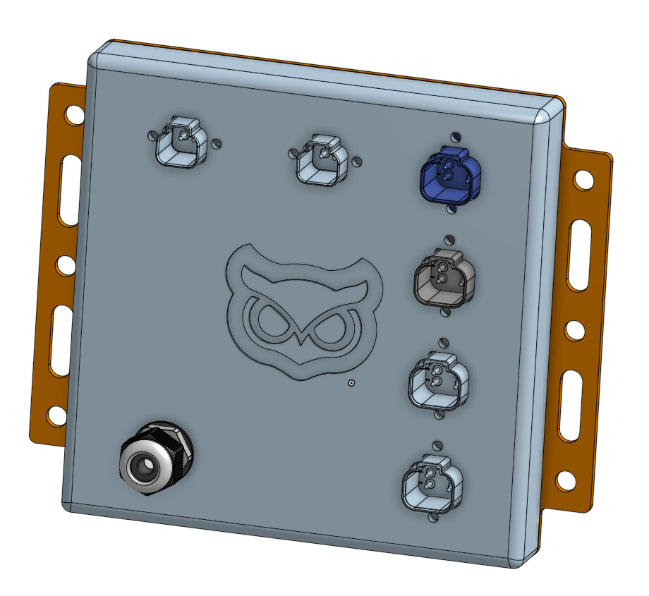

These are the power distribution boxes as well on their way.
Each supports:
  1. 4x 12V 7A outputs (4x OWLs)
  2. daisy chaining of the hardware triggered OWL output enable - so you can toggle all nozzles on/off across the boom with one non-software switch. It will also be built into the software.
  3. Soft start - the four outputs have delayed start between them and delay between nozzle activation so you can never accidentally switch 100 nozzles on/off at exactly the same time.
  4. Rated to a 40A input. Most will consume less than this, but depends on the solenoids/relays you use to switch nozzles. Some cheaper ones can consume 1.5A at 12V.
The idea is to use one for every 4 OWLs spread across the machine.
This is our first prototype of this, so we will learn a lot from it and improve the design after this iteration.

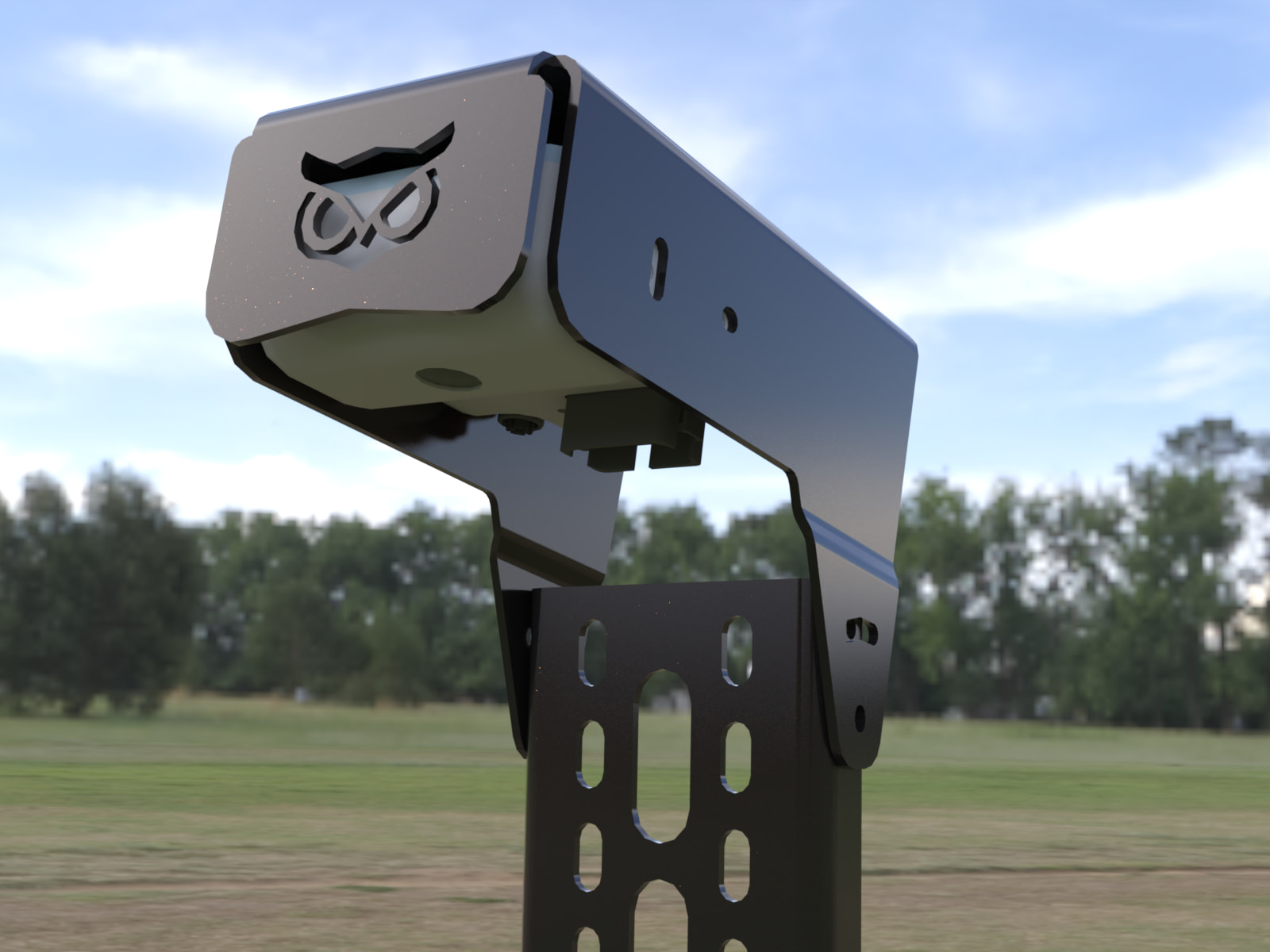

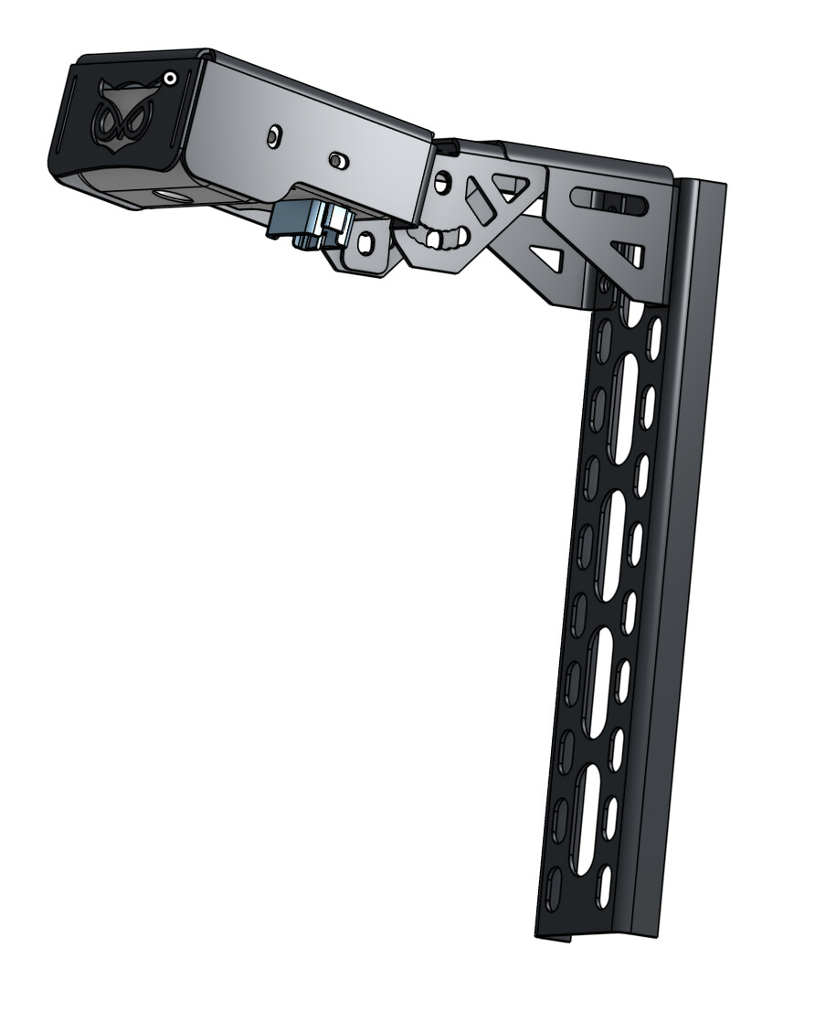

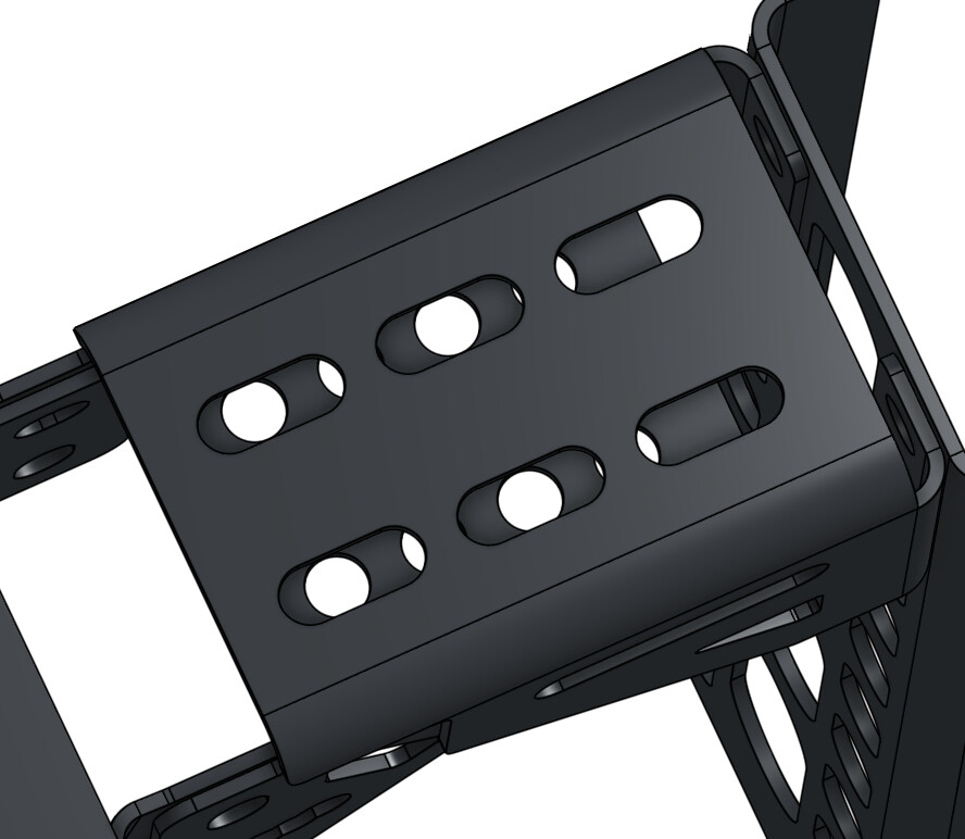

Updated design for the mount. A few improvements:
  1. much more compact
  2. incorporates a non-slip design for the variable angle - thanks @ben for the suggestion! Small ridges between each angle should hold it in addition to the nut.
  3. variable length extension/mount - so it can be adjusted for different boom layouts
  4. A lot lighter - we’ll go for 2mm steel on the enclosure shield so there isn’t so much weight on the boom.
