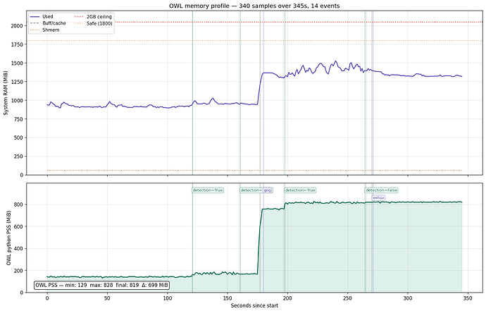

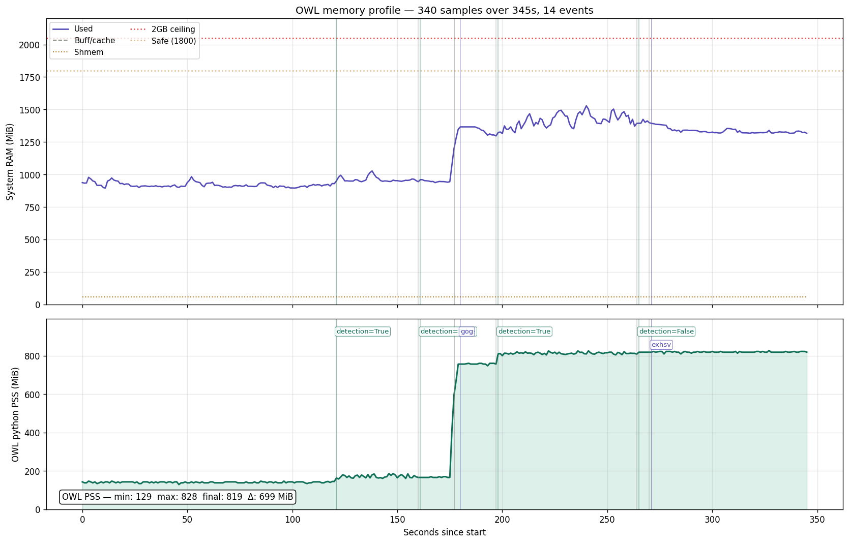

Ran some tests today on the 8GB Pi this evening using the full 1456 x 1088 resolution for the IMX296 Global Shutter camera. Each line is a change/event, focusing on the green for the changes in Python RAM usage:
- Turn on exhsv ‘green’ detection - only a very slight increase (around 200MB RAM)
- Load the YOLO11-N.py Pytorch model - jumps up to approx. 775MB
- With detection on it jumps up to above 800MB
Remember this is at full resolution, on a desktop version of Raspbian running non-optimised models.
So I think we’ll be using 2GB models from now on in. 1GB just seems rather risky (and not feasible unless you’re using Raspbian Lite without the desktop). Even with a Hailo chip, there will still be some RAM overhead when loading the model.
